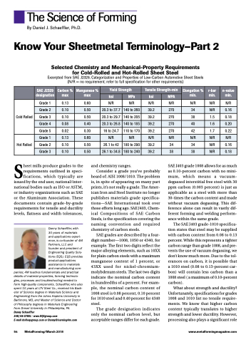

Selected Chemistry and Mechanical-Property Requirements
for Cold-Rolled and Hot-Rolled Sheet Steel
Excerpted from SAE J2329, Categorization and Properties of Low-Carbon Automotive Sheet Steels (N/R = no requirement; refer to full specification for other requirements)
             SAE J2329 designation
 Carbon % max
 Manganese % max
 Yield Strength
 Tensile Strength-min
 Elongation % min.
 r-bar min.
 n-value min.
 ksi
 MPa
 ksi
 MPA
Cold Rolled
Grade 1
0.13
0.60
N/R
N/R
N/R
N/R
N/R
N/R
N/R
Grade 2
0.10
0.50
20.3 to 37.7
140 to 260
39.2
270
34
N/R
0.16
Grade 3
0.10
0.50
20.3 to 29.7
140 to 205
39.2
270
38
1.5
0.18
Grade 4
0.08
0.40
20.3 to 26.8
140 to 185
39.2
270
40
1.6
0.20
Grade 5
0.02
0.30
16 to 24.7
110 to 170
39.2
270
42
1.7
0.22
Hot Rolled
Grade 1
0.13
0.60
N/R
N/R
N/R
N/R
N/R
N/R
N/R
Grade 2
0.10
0.50
26.1 to 42
180 to 290
39.2
34
34
N/R
0.16
Grade 3
0.10
0.50
26.1 to 34.8
180 to 240
39.2
38
38
N/R
0.18
                     Sheet mills produce grades to the requirements outlined in speci- fications, which typically are issued by the end user, national/inter- national bodies such as ISO or ASTM, or industry organizations such as SAE or the Aluminum Association. These documents contain grade-by-grade requirements for tensile and ductility levels, flatness and width tolerances,

Consider a grade you’ve probably
heard of: AISI 1008/1010. The problem is, in spite of appearing on many part prints, it’s not really a grade. The Amer- ican Iron and Steel Institute no longer publishes materials grade specifica- tions—SAE International took over those efforts long ago. SAE J403, Chem- ical Compositions of SAE Carbon Steels, is the specification covering the naming convention and required chemistry of carbon steels.
SAE grades are described by a four- digit number—1008, 1050 or 4340, for example. The first two digits reflect the major alloying elements, such as 10XX for plain carbon steels with a maximum manganese content of 1 percent, or 43XX used for nickel-chromium- molybdenum steels. The last two digits indicate the nominal carbon content in hundredths of a percent. For exam- ple, the nominal carbon content of 1008 steel is 0.08 percent, 0.10 percent for 1010 steel and 0.40 percent for 4340 steel.
The grade designation indicates only the nominal carbon level, but acceptable ranges differ for each grade.
SAE J403 grade 1008 allows for as much as 0.10-percent carbon with no mini- mum, which means a vacuum- degassed interstitial free steel with 30 ppm carbon (0.003 percent) is just as applicable as a steel with more than 30-times the carbon content and made without vacuum degassing. This dif- ference alone can result in vastly dif- ferent forming and welding perform- ance within the same grade.
The SAE J403 grade-1010 specifica- tion states that steel may be supplied with carbon content from 0.08 to 0.13 percent. While this represents a tighter carbon range than grade 1008, and pre- vents the use of vacuum degassing, we don’t know much more. Due to the tol- erances on carbon, it is possible that a 1010 steel (0.08 to 0.13-percent car- bon) will contain less carbon than a 1008 steel ( a maximum of 0.10-percent carbon).
What about strength and ductility? Unfortunately, specifications for grades 1008 and 1010 list no tensile require- ments. We know that higher carbon content typically translates to higher strength and lower ductility. However, processing also plays a significant role
