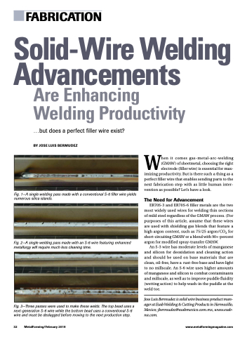

Fig. 1—A single welding pass made with a conventional S-6 filler wire yields numerous silica islands.
Fig. 2—A single welding pass made with an S-6 wire featuring enhanced metallurgy will require much less cleaning time.

ER70S-3 and ER70S-6 filler metals are the two most widely used wires for welding thin sections of mild steel regardless of the GMAW process. (For purposes of this article, assume that these wires are used with shielding gas blends that feature a high argon content, such as 75/25 argon/CO2 for short-circuiting GMAW or a blend with 90+-percent argon for modified spray-transfer GMAW.
An S-3 wire has moderate levels of manganese and silicon for deoxidation and cleaning action and should be used on base materials that are clean, oil-free, have a rust-free base and have light to no millscale. An S-6 wire uses higher amounts of manganese and silicon to combat contaminants and millscale, as well as to improve puddle fluidity (wetting action) to help wash-in the puddle at the weld toe.

    Fig. 3—Three passes were used to make these welds. The top bead uses a next-generation S-6 wire while the bottom bead uses a conventional S-6 wire and must be deslagged before moving to the next production step.
