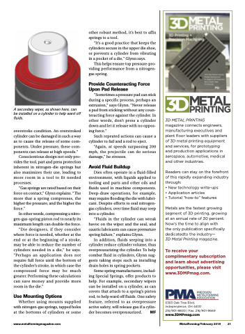

                                 A secondary wiper, as shown here, can be installed on a cylinder to help ward off fluids.

Avoid Fluid Buildup
Dies often operate in a fluid-filled environment, with liquids applied to tooling and parts and other oils and fluids used in machine components. Deep-draw operations, for example, may require flooding the die with lubri- cant. Despite efforts to seal nitrogen- gas cylinders, over time fluid may seep into a cylinder.
“Fluids in the cylinder can wreak havoc on the wiper and the seal, and caustic lubricants can cause premature spring failure,” explains Glynn.
In addition, fluids seeping into a cylinder reduce cylinder volume, thus overpressurizing the cylinder. To help combat fluid in cylinders, Glynn sug- gests taking steps such as installing drain holes in spring pockets.
Some spring manufacturers, includ- ing Special Springs, offer products to help. For example, secondary wipers can be installed on a cylinder, as can covers that attach to a spring’s piston rod, to help ward off fluids. One safety feature, referred to as overpressure active safety, will release gas if a cylin- der becomes overpressurized. MF
