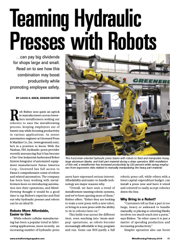

This horizontal-oriented hydraulic press teams with robots to feed and manipulate heavy, large aluminum blanks, and hold part material during a draw operation. With installation of this cell, a metalformer has increased productivity by 233 percent while saving employ- ees from ergonomic risks related to manually manipulating the heavy part material.
