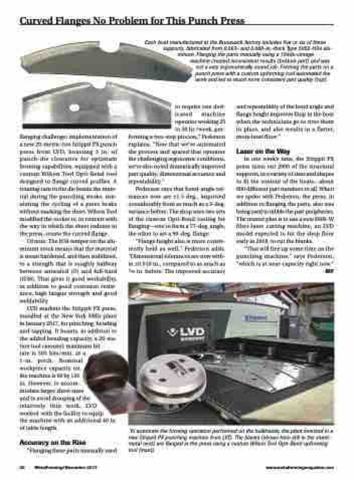

 flanging challenge: implementation of a new 20-metric-ton Strippit PX punch press from LVD, boasting 3 in. of punch-die clearance for optimum forming capabilities, equipped with a custom Wilson Tool Opti-Bend tool designed to flange curved profiles. A rotating cam in the die bends the mate- rial during the punching stroke, sim- ulating the cycling of a press brake without marking the sheet. Wilson Tool modified the rocker to, in concert with the way in which the sheet indexes in the press, create the curved flange.

“Flanging these parts manually used
to require one ded- icated machine operator working 25 to 30 hr./week, per-
forming a two-step process,” Pederson explains. “Now that we’ve automated the process and spared that operator the challenging ergonomic conditions, we’ve also noted dramatically improved part quality, dimensional accuracy and repeatability.”
Pederson says that bend-angle tol- erances now are ±1.5 deg., improved considerably from as much as a 3-deg. variance before. The shop uses two sets of the custom Opti-Bend tooling for flanging—one to form a 77-deg. angle, the other to set a 90-deg. flange.
“Flange height also is more consis- tently held as well,” Pederson adds. “Dimensional tolerances are now with- in ±0.010 in., compared to as much as 1⁄16 in. before. The improved accuracy
and repeatability of the bend angle and flange height improves fitup in the boat when the technicians go to rivet them in place, and also results in a flatter, more level floor.”

Each boat manufactured at the Brunswick factory includes five or six of these supports, fabricated from 0.063- and 0.080-in.-thick Type 5052-H34 alu-
minum. Flanging the parts manually using a 1940s-vintage machine created inconsistent results (bottom part) and was
not a very ergonomically sound job. Forming the parts on a punch press with a custom upforming tool automated the work and led to much more consistent part quality (top).

To automate the forming operation performed on the bulkheads, the plant invested in a new Strippit PX punching machine from LVD. The blanks (shown here still in the sheet- metal nest) are flanged in the press using a custom Wilson Tool Opti-Bend upforming tool (inset).
