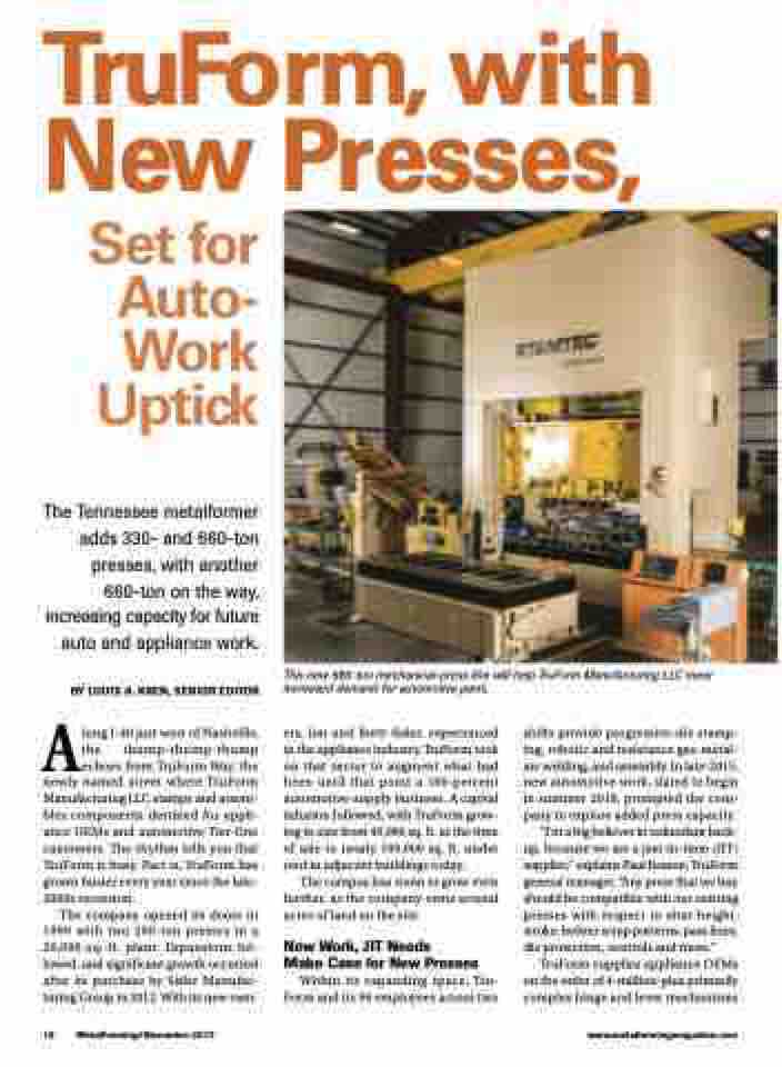

TruForm, with New Presses,
     The Tennessee metalformer adds 330- and 660-ton presses, with another 660-ton on the way, increasing capacity for future auto and appliance work.
Along I-40 just west of Nashville, the thump-thump-thump echoes from TruForm Way, the newly named street where TruForm Manufacturing LLC stamps and assem- bles components destined for appli- ance OEMs and automotive Tier One customers. The rhythm tells you that TruForm is busy. Fact is, TruForm has grown busier every year since the late- 2000s recession.
The company opened its doors in 1999 with two 200-ton presses in a 20,000-sq.-ft. plant. Expansions fol- lowed, and significant growth occurred after its purchase by Sisler Manufac- turing Group in 2012. With its new own-
This new 660-ton mechanical-press line will help TruForm Manufacturing LLC meet increased demand for automotive parts.
