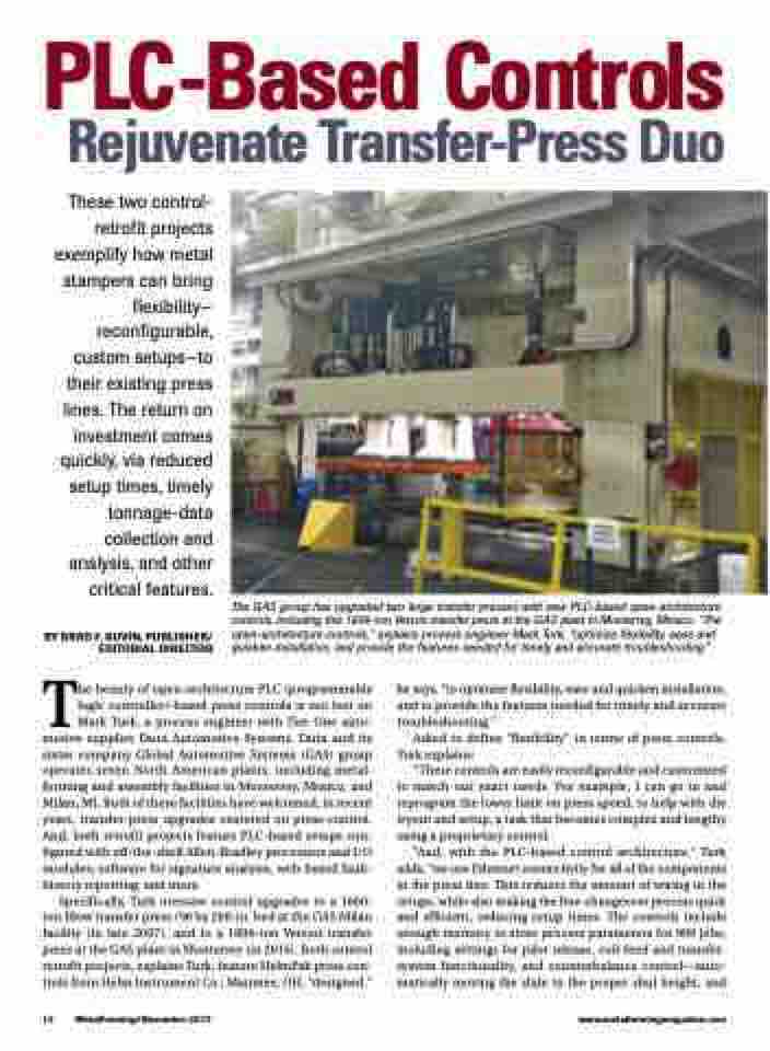

The GAS group has upgraded two large transfer presses with new PLC-based open-architecture controls, including this 1600-ton Verson transfer press at the GAS plant in Monterrey, Mexico. “The open-architecture controls,” explains process engineer Mark Turk, “optimize flexibility, ease and quicken installation, and provide the features needed for timely and accurate troubleshooting.”
