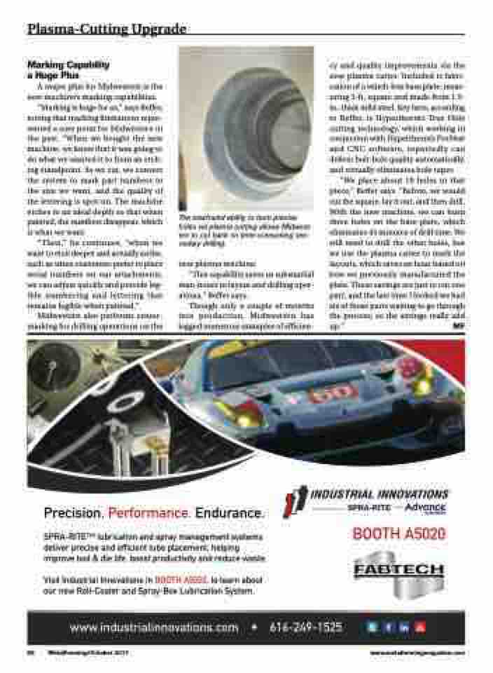

The newfound ability to burn precise holes via plasma cutting allows Midwest- ern to cut back on time-consuming sec- ondary drilling.
new plasma machine.
