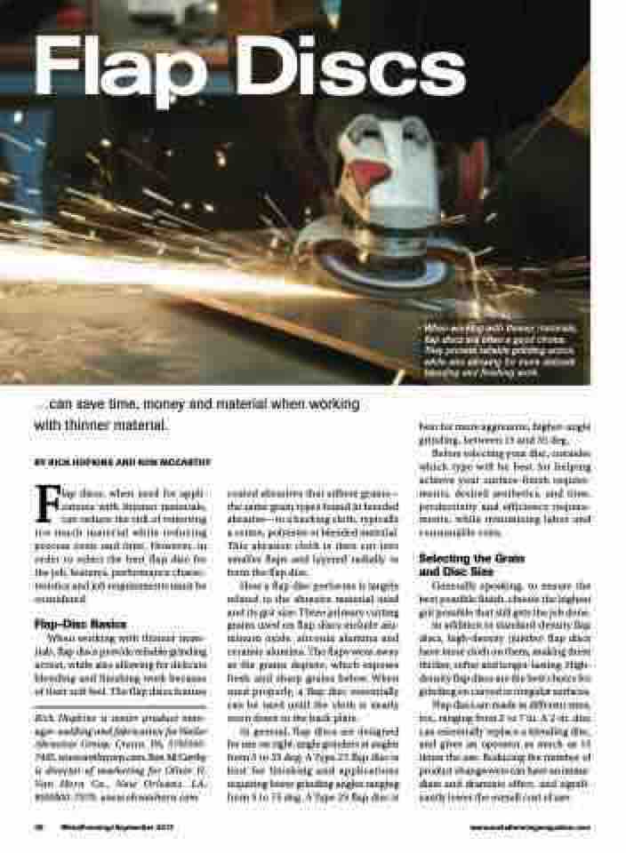

 Flap Discs
 When working with thinner materials, flap discs are often a good choice. They provide reliable grinding action, while also allowing for more delicate blending and finishing work.

Flap discs, when used for appli- cations with thinner materials, can reduce the risk of removing too much material while reducing process costs and time. However, in order to select the best flap disc for the job, features, performance charac- teristics and job requirements must be considered.
Flap-Disc Basics
When working with thinner mate- rials, flap discs provide reliable grinding action, while also allowing for delicate blending and finishing work because of their soft feel. The flap discs feature
