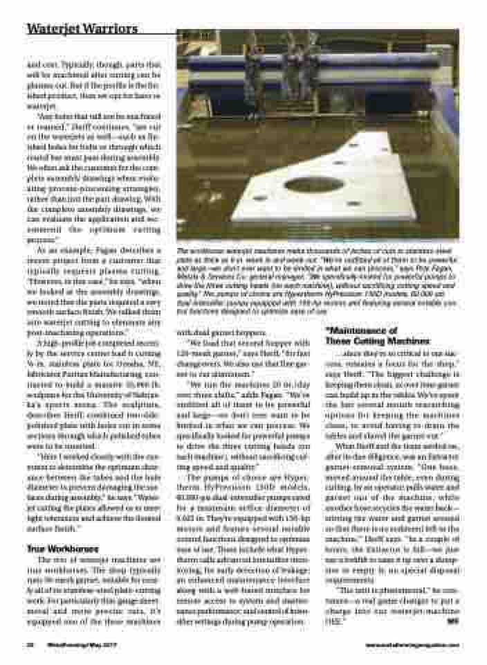

The workhorse waterjet machines make thousands of inches of cuts in stainless-steel plate as thick as 6 in. week in and week out. “We’ve outfitted all of them to be powerful and large—we don’t ever want to be limited in what we can process,” says Pete Fagan, Metals & Services Co. general manager. “We specifically looked for powerful pumps to drive the three cutting heads (on each machine), without sacrificing cutting speed and quality.” The pumps of choice are Hypertherm HyPrecision 150D models, 60,000-psi dual-intensifier pumps equipped with 150-hp motors and featuring several notable con- trol functions designed to optimize ease of use.

“We run the machines 20 hr./day over three shifts,” adds Fagan. “We’ve outfitted all of them to be powerful and large—we don’t ever want to be limited in what we can process. We specifically looked for powerful pumps to drive the three cutting heads (on each machine), without sacrificing cut- ting speed and quality.”
The pumps of choice are Hyper- therm HyPrecision 150D models, 60,000-psi dual-intensifier pumps rated for a maximum orifice diameter of 0.025 in. They’re equipped with 150-hp motors and feature several notable control functions designed to optimize ease of use. These include what Hyper- therm calls advanced intensifier mon- itoring, for early detection of leakage; an enhanced maintenance interface along with a web-based interface for remote access to system and mainte- nance performance; and control of inten- sifier settings during pump operation.
