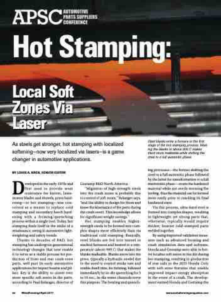

As steels get stronger, hot stamping with localized softening—now very localized via lasers—is a game changer in automotive applications.
Steel blanks enter a furnace in the first stage of the hot-stamping process. Heat- ing the blanks to above 900 C makes them more malleable while shifting the steel to a full austenitic phase.
