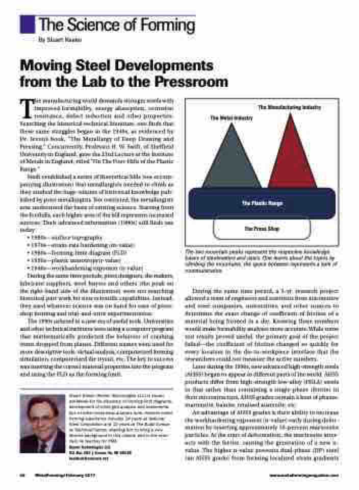

Swift established a series of theoretical hills (see accom- panying illustration) that metallurgists needed to climb as they studied the huge volume of historical knowledge pub- lished by prior metallurgists. Not restricted, the metallurgists now understood the basis of existing science. Starting from the foothills, each higher area of the hill represents increased success. Their advanced information (1900s) still finds use today:
• 1980s—surface topography
• 1970s—strain-rate hardening (m-value)
• 1960s—forming-limit diagram (FLD)
• 1950s—plastic anisotropy(r-value)
• 1940s—workhardening exponent (n-value)
During the same time periods, press designers, die makers,
lubricant suppliers, steel buyers and others (the peak on the right-hand side of the illustration) were not searching historical past work for new scientific capabilities. Instead, they used whatever science was on hand for ease of press- shop forming and trial-and-error experimentation.

The two mountain peaks represent the respective knowledge bases of steelmakers and users. One learns about the topics by climbing the mountains; the space between represents a lack of communication.

 The Metal Industry
The Manufacturing Industry
The Plastic Range
The Press Shop
