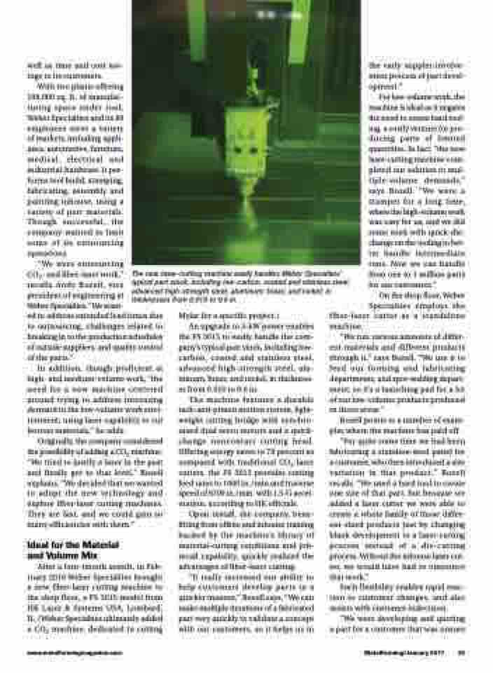

The new laser-cutting machine easily handles Weber Specialties’ typical part stock, including low-carbon, coated and stainless steel; advanced high-strength steel; aluminum; brass; and nickel; in thicknesses from 0.010 to 0.5 in.
