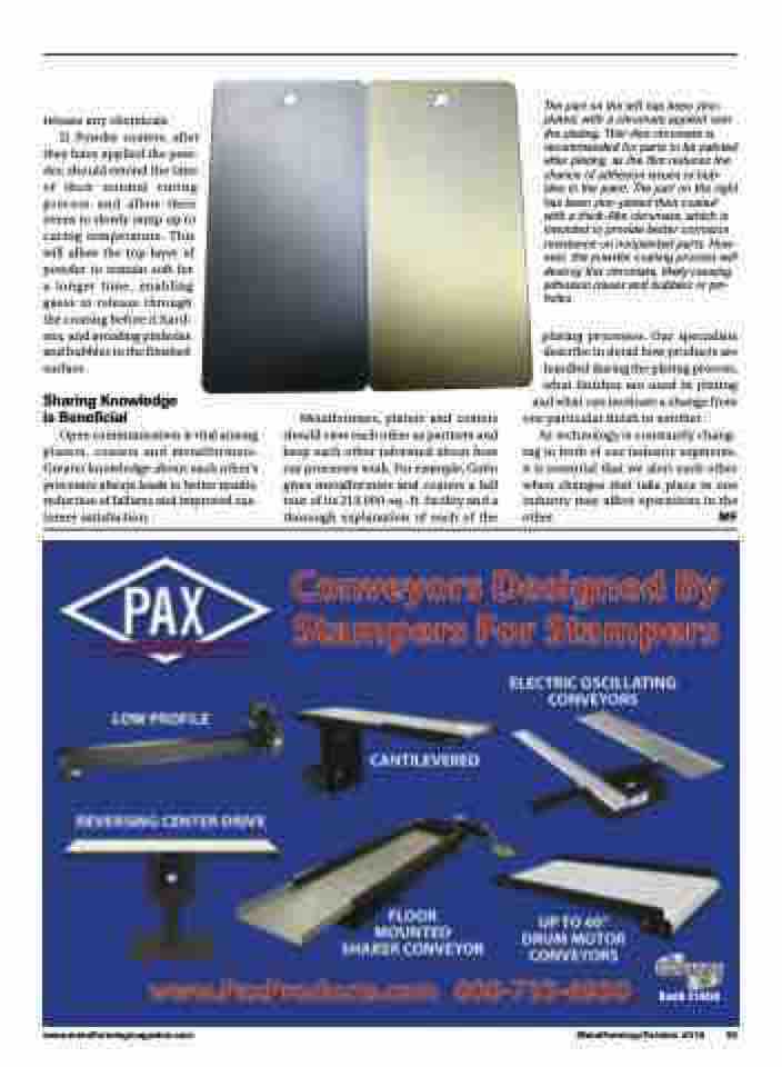

The part on the left has been zinc- plated, with a chromate applied over the plating. Thin-film chromate is recommended for parts to be painted after plating, as the film reduces the chance of adhesion issues or bub- bles in the paint. The part on the right has been zinc-plated then coated with a thick-film chromate, which is intended to provide better corrosion resistance on nonpainted parts. How- ever, the powder-coating process will destroy this chromate, likely causing adhesion issues and bubbles or pin- holes.
