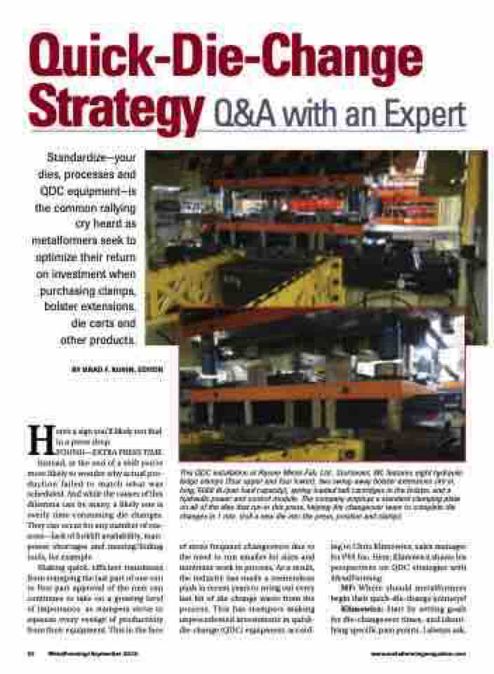

This QDC installation at Racine Metal-Fab, Ltd., Sturtevant, WI, features eight hydraulic ledge clamps (four upper and four lower), two swing-away bolster extensions (40 in. long, 6000 lb./pair load capacity), spring-loaded ball cartridges in the bolster, and a hydraulic power and control module. The company employs a standard clamping plate on all of the dies that run in this press, helping the changeover team to complete die changes in 1 min. (roll a new die into the press, position and clamp).
