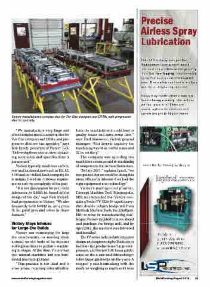

                           Victory manufactures complex dies for Tier One stampers and OEMs, with progressive dies its specialty.
