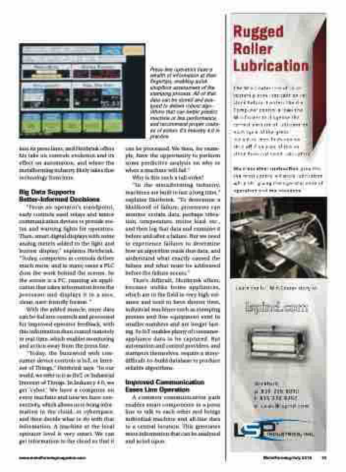

   into its press lines, and Heitbrink offers his take on controls evolution and its effect on automation, and where the metalforming industry likely takes that technology from here.
Big Data Supports Better-Informed Decisions
“From an operator’s standpoint, early controls used relays and minor communication devices to provide sta- tus and warning lights for operators. Then, smart digital displays with some analog meters added to the light and button display,” explains Heitbrink. “Today, computers in controls deliver much more, and in many cases a PLC does the work behind the scenes. So the screen is a PC, running an appli- cation that takes information from the processor and displays it in a nice, clean, user-friendly format. “
With the added muscle, more data can be fed into controls and processed for improved operator feedback, with this information then routed remotely in real-time, which enables monitoring and action away from the press line.
“Today, the buzzword with con- sumer-device controls is IoT, or Inter- net of Things,” Heitbrink says. “In our world, we refer to it as IIoT, or Industrial Internet of Things. In Industry 4.0, we get ‘cyber.’ We have a computer on every machine and now we have con- nectivity, which allows us to bring infor- mation to the cloud, or cyberspace, and then decide what to do with that information. A machine at the local operator level is very smart. We can get information to the cloud so that it
Press-line operators have a wealth of information at their fingertips, enabling quick shopfloor assessment of the stamping process. All of that data can be stored and ana- lyzed to deliver robust algo- rithms that can better predict machine or line performance, and recommend proper cours- es of action. It’s Industry 4.0 in practice.
can be processed. We then, for exam- ple, have the opportunity to perform some predictive analysis on why or when a machine will fail.”
