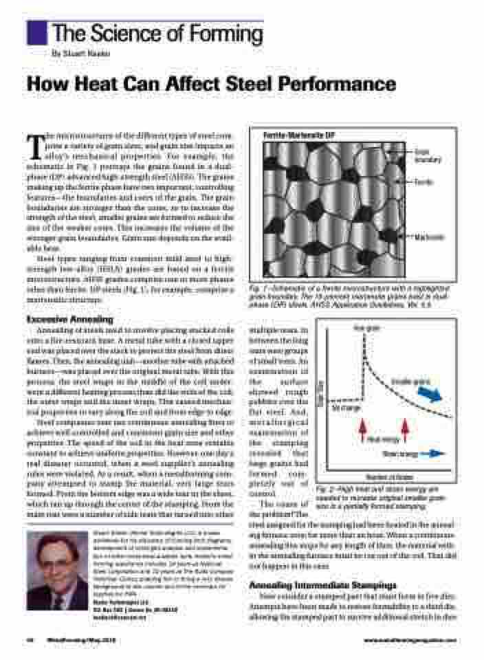

 Ferrite-Martensite DP
           Grain boundary
Ferrite
Martensite
                                The microstructures of the different types of steel com- prise a variety of grain sizes, and grain size impacts an alloy’s mechanical properties. For example, the schematic in Fig. 1 portrays the grains found in a dual- phase (DP) advanced high-strength steel (AHSS). The grains making up the ferrite phase have two important, controlling features—the boundaries and cores of the grain. The grain boundaries are stronger than the cores, so to increase the strength of the steel, smaller grains are formed to reduce the size of the weaker cores. This increases the volume of the stronger grain boundaries. Grain size depends on the avail- able heat.

Fig. 1—Schematic of a ferrite microstructure with a highlighted grain boundary. The 10-percent martensite grains exist in dual- phase (DP) steels. AHSS Application Guidelines, Ver. 5.0.

Heat energy
Strain energy
Number of Grains
One grain
    Fig. 2—High heat and strain energy are needed to recreate original smaller grain size in a partially formed stamping.
