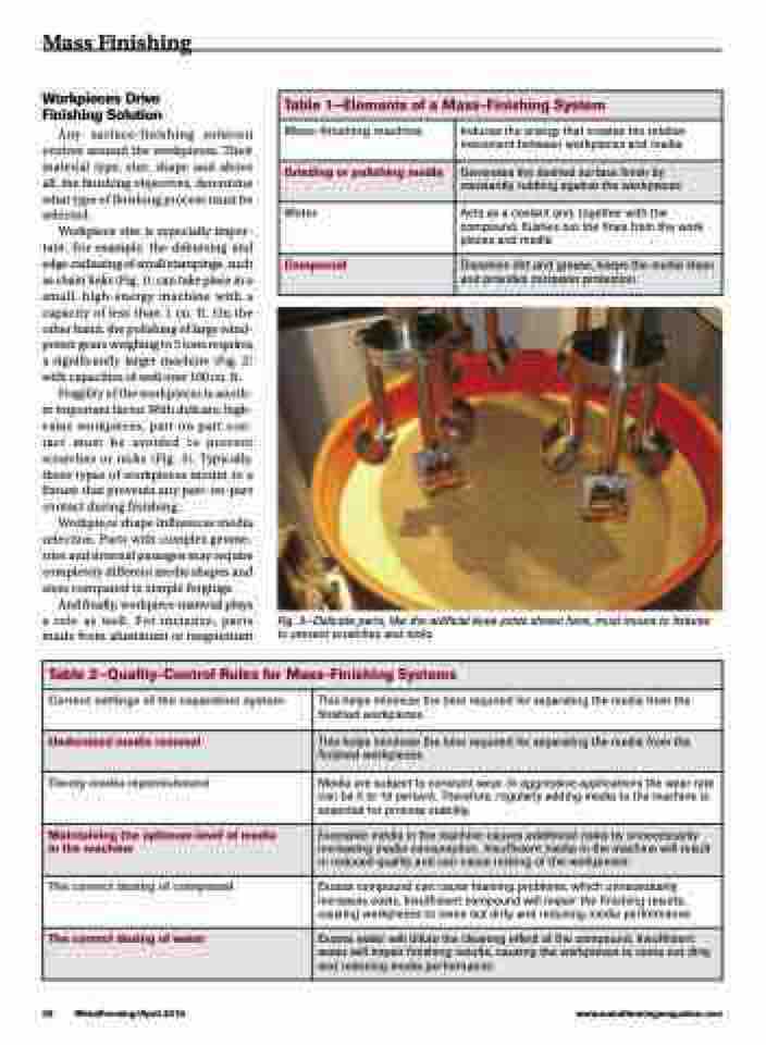

Fragility of the workpieces is anoth- er important factor. With delicate, high- value workpieces, part-on-part con- tact must be avoided to prevent scratches or nicks (Fig. 3). Typically, these types of workpieces mount to a fixture that prevents any part-on-part contact during finishing.

Fig. 3—Delicate parts, like the artificial knee joints shown here, must mount to fixtures to prevent scratches and nicks.
