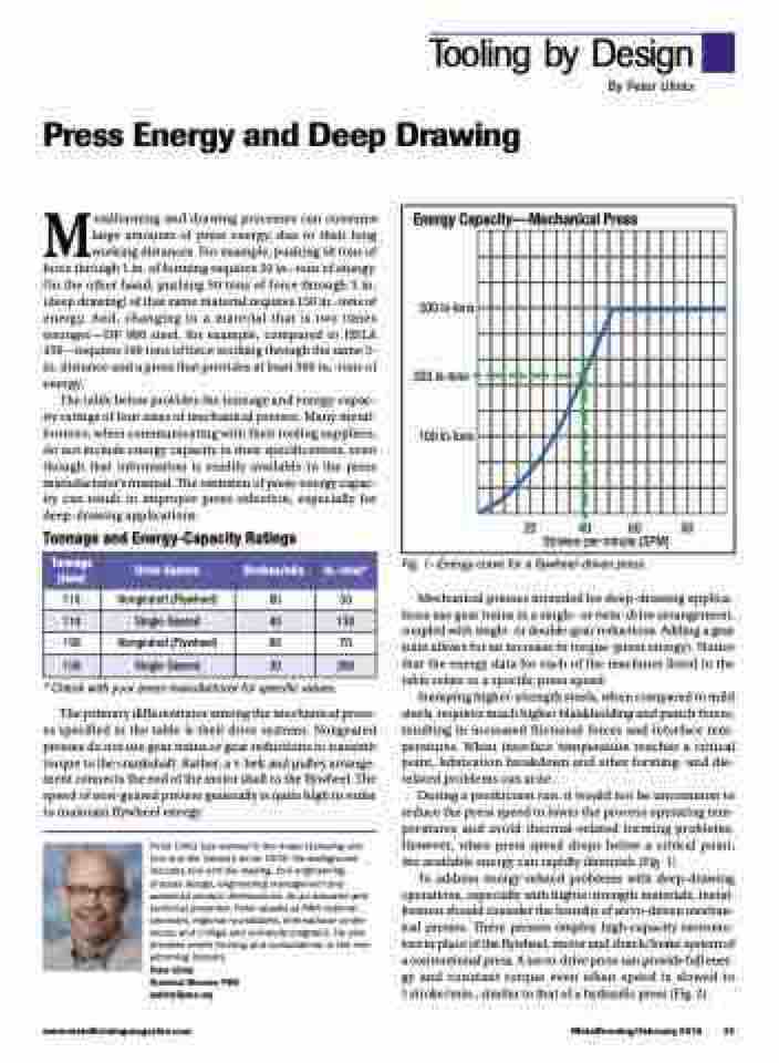

  Press Energy and Deep Drawing

  Energy Capacity—Mechanical Press
                                                         300 in-tons
200 in-tons
100 in-tons
                                                                                                                                                      20 40 60 80 Strokes-per-minute (SPM)

Fig. 1—Energy curve for a flywheel-driven press.

During a production run, it would not be uncommon to reduce the press speed to lower the process operating tem- peratures and avoid thermal-related forming problems. However, when press speed drops below a critical point, the available energy can rapidly diminish (Fig. 1).
