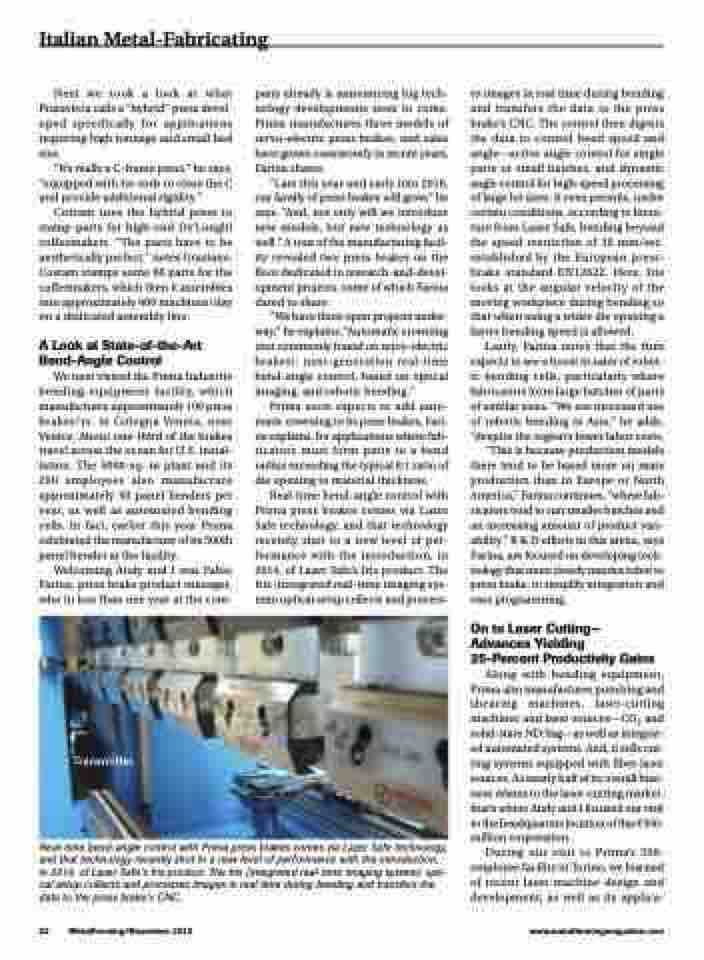

Real-time bend-angle control with Prima press brakes comes via Lazer Safe technology, and that technology recently shot to a new level of per- formance with the introduction, in 2014, of Lazer Safe’s Iris product. The Iris (integrated real-time imaging sys- tem) optical setup collects and process-
es images in real time during bending and transfers the data to the press brake’s CNC. The control then digests the data to control bend speed and angle—active angle control for single parts or small batches, and dynamic angle control for high-speed processing of large lot sizes. It even permits, under certain conditions, according to litera- ture from Lazer Safe, bending beyond the speed restriction of 10 mm/sec. established by the European press- brake standard EN12622. Here, Iris looks at the angular velocity of the moving workpiece during bending so that when using a wider die opening a faster bending speed is allowed.

  Transmitter
Real-time bend-angle control with Prima press brakes comes via Lazer Safe technology, and that technology recently shot to a new level of performance with the introduction, in 2014, of Lazer Safe’s Iris product. The Iris (integrated real-time imaging system) opti- cal setup collects and processes images in real time during bending and transfers the data to the press brake’s CNC.
