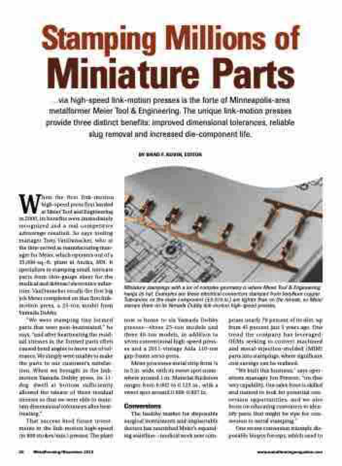

Miniature stampings with a lot of complex geometry is where Meier Tool & Engineering hangs its hat. Examples are these electrical connectors stamped from beryllium copper. Tolerances on the male component (±0.010 in.) are tighter than on the female, so Meier stamps them on its Yamada Dobby link-motion high-speed presses.
