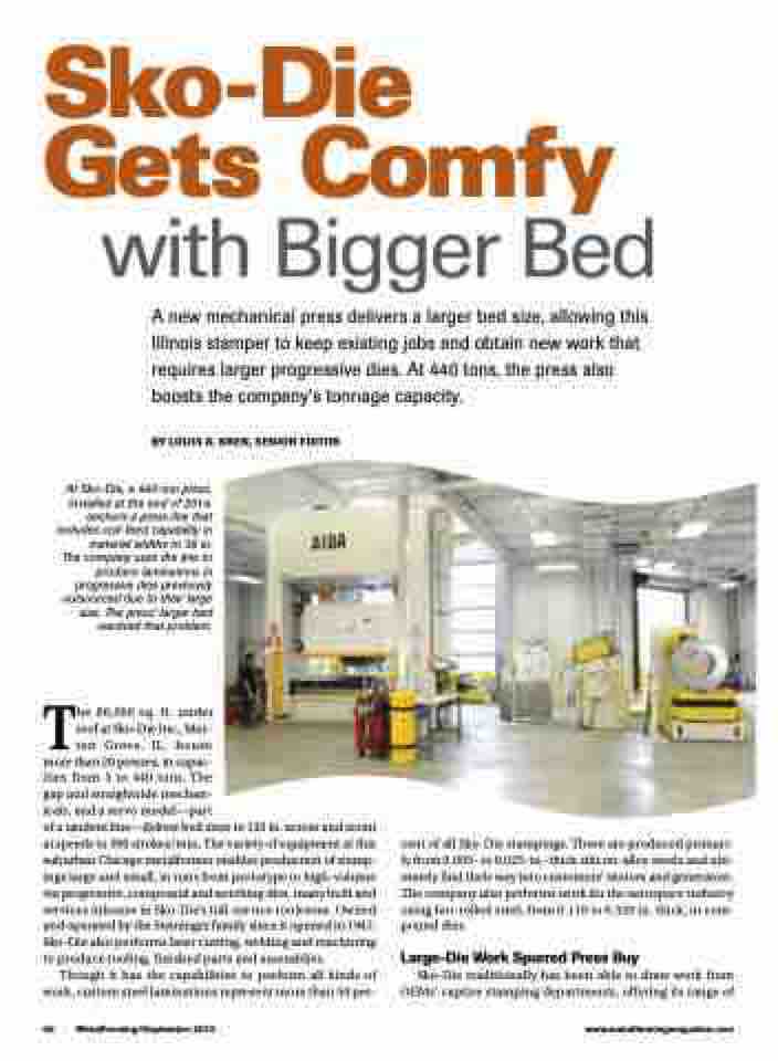

Sko-Die Gets Comfy
A new mechanical press delivers a larger bed size, allowing this Illinois stamper to keep existing jobs and obtain new work that requires larger progressive dies. At 440 tons, the press also boosts the company’s tonnage capacity.
At Sko-Die, a 440-ton press, installed at the end of 2014, anchors a press line that includes coil-feed capability in material widths to 36 in. The company uses the line to produce laminations in progressive dies previously outsourced due to their large size. The press’ larger bed resolved that problem.
