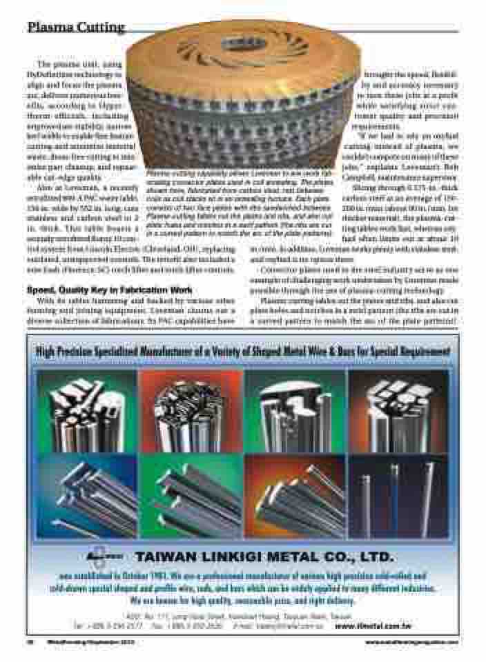

Convector plates used in the steel industry serve as one example of challenging work undertaken by Loveman made possible through the use of plasma-cutting technology.
Plasma-cutting tables cut the plates and ribs, and also cut plate holes and notches in a swirl pattern (the ribs are cut in a curved pattern to match the arc of the plate patterns).
36 MetalForming/September 2015
Plasma-cutting capability allows Loveman to win work fab- ricating convector plates used in coil annealing. The plates shown here, fabricated from carbon steel, rest between coils as coil stacks sit in an annealing furnace. Each plate consists of two face plates with ribs sandwiched between. Plasma-cutting tables cut the plates and ribs, and also cut plate holes and notches in a swirl pattern (the ribs are cut in a curved pattern to match the arc of the plate patterns).
