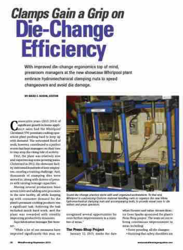

Sound die-change practice starts with well-organized workstations. To that end, Whirlpool is customizing Creform material-handling carts to organize the new Hilma hydromechanical clamping nuts and accompanying bolts, to provide visual cues to die setters and press operators.
