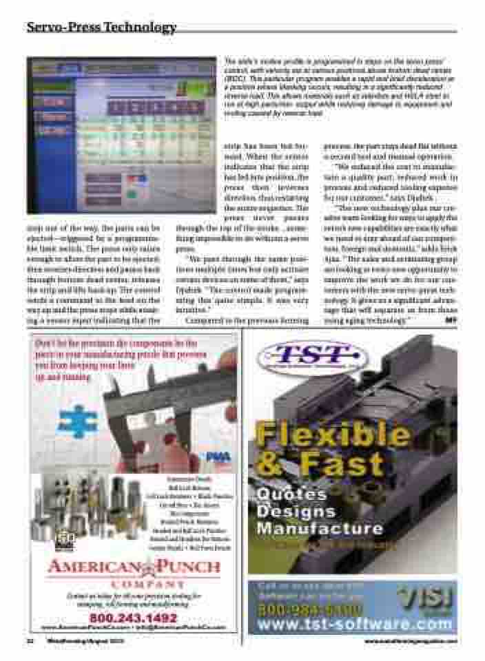

The slide’s motion profile is programmed in steps on the servo press’ control, with velocity set at various positions above bottom dead center (BDC). This particular program enables a rapid and brief deceleration at a position where blanking occurs, resulting in a significantly reduced reverse load. This allows materials such as stainless and HSLA steel to run at high parts/min. output while reducing damage to equipment and tooling caused by reverse load.
