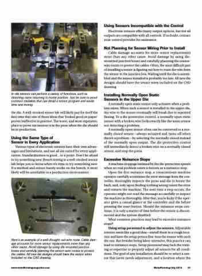

 In-die sensors can perform a variety of functions, such as detecting cams returning to home position. Just be sure to avoid common mistakes that can derail a sensor program and waste time and money.

Here’s an example of a well-thought-out wire route. Cable dam- age accounts for more sensor replacements more than any other cause. Avoid damage by using die-mounted junction boxes and carefully planning the sensor-wire routes to protect the cables. All new die designs should have the sensor wires included on the CAD drawing.

Not Planning for Sensor Wiring Prior to Install
Cable damage accounts for more sensor replacements more than any other cause. Avoid damage by using die- mounted junction boxes and carefully planning the sensor- wire routes to protect the cables. Often, the most difficult part of installing a sensor is figuring out how to route the wire from the sensor to the junction box. Waiting until the die is assem- bled and the sensor installed is probably too late. All new die designs should have the sensor wires included on the CAD drawing.
Installing Normally Open Static Sensors in the Upper Die
A normally open static sensor only actuates when a prob- lem exists. When such a sensor is installed in the upper die, the wire to the sensor eventually will break due to repeated flexing. To a die-protection control, a normally open static sensor with a broken wire looks exactly like the same sensor not detecting a problem.
A normally open sensor often can be converted to a nor- mally closed sensor—always actuated and turns off when there’s a problem − by selecting the normally closed instead of the normally open output. The die-protection control will immediately detect a broken wire on a normally closed sensor, and stop the press.
