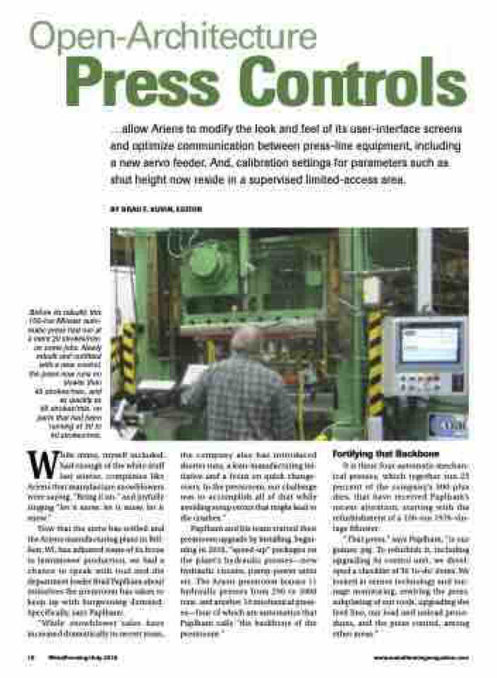

 Before its rebuild, this 150-ton Minster auto- matic press had run at a mere 20 strokes/min.
on some jobs. Newly rebuilt and outfitted with a new control, the press now runs no slower than 45 strokes/min., and as quickly as 85 strokes/min. on parts that had been running at 30 to 40 strokes/min.
