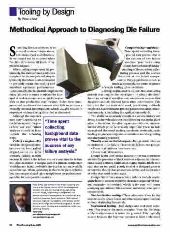

Methodical Approach to Diagnosing Die Failure
 Stamping dies are subjected to an array of stresses, temperatures, chemicals, shock and vibrations. So we should not be surprised when the dies experience all kinds of in- process failures.
When tooling components fail pre-
maturely, the stamper must perform a completefailureanalysisandproper-
ly identify the failure mode(s) in order
to properly repair the tooling and
maintain optimum performance.

Compile background data— Time spent collecting back- ground data proves vital to the success of any failure analysis. Your technicians should have a thorough under- standing of the entire manufac- turing process and the service histories of the failed compo- nent(s). They should reconstruct, as much as is possible, the entire sequence
ofeventsleadinguptothefailure.
Getting acquainted with the manufacturing
process may require the investigator to obtain die-detail drawings, technical specifications, component process-flow diagrams and all relevant fabrication information. This includes the die materials used, machining methods employed, heattreatment-process parameters and surface- treatment data, including the application methods.
The ability to accurately complete a service history will depend on how detailed the recordkeeping was in the plant prior to the failure. In collecting service histories, environ- mental details prove particularly important. These include normal and abnormal loading, accidental overloads, cyclic loading, in-process temperature variations and die-grinding and sharpening practices.
