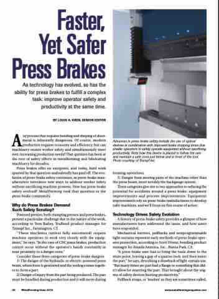

Advances in press-brake safety include the use of optical devices in combination with improved brake stopping times that enable operators to safely operate equipment without sacrificing productivity. Note how this device is placed to follow the ram and maintain a safe zone just below and in front of the tool. Photo courtesy of Trumpf Inc.
