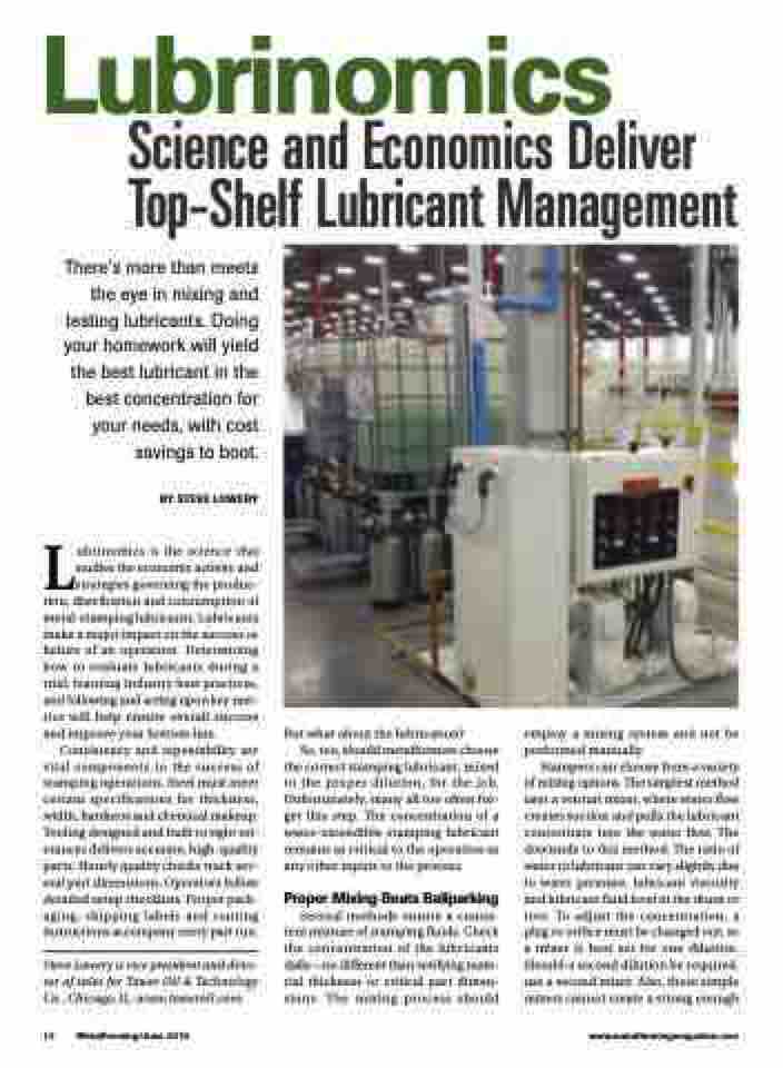

So, too, should metalformers choose the correct stamping lubricant, mixed to the proper dilution, for the job. Unfortunately, many all too often for- get this step. The concentration of a water-extendible stamping lubricant remains as critical to the operation as
any other inputs to the process.
Proper Mixing Beats Ballparking
Several methods ensure a consis- tent mixture of stamping fluids. Check the concentration of the lubricants daily—no different than verifying mate- rial thickness or critical part dimen- sions. The mixing process should
employ a mixing system and not be performed manually.
Stampers can choose from a variety of mixing options. The simplest method uses a venturi mixer, where water flow creates suction and pulls the lubricant concentrate into the water flow. The downside to this method: The ratio of water to lubricant can vary slightly due to water pressure, lubricant viscosity and lubricant fluid level in the drum or tote. To adjust the concentration, a plug or orifice must be changed out, so a mixer is best set for one dilution. Should a second dilution be required, use a second mixer. Also, these simple mixers cannot create a strong enough
