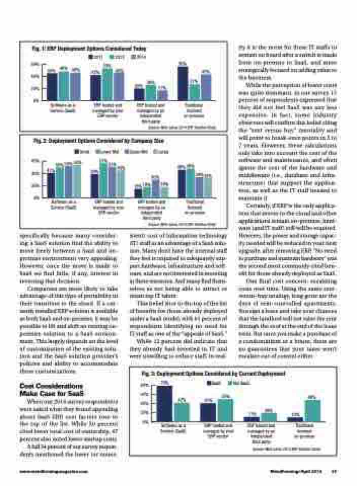

  Fig. 1: ERP Deployment Options Considered Today
   60%
40% 20% 0%
2011 42%
53%
2013 46%
2014
20%
56%
  45% 48% 46%
Software as a Service (SaaS)
43%
               ERP hosted and managed by your ERP vendor
ERP hosted and managed by an independent third party
Traditional licensed on-premise
26%
27%
17%
 Source: Mint Jutras 2014 ERP Solution Study
  Fig. 2: Deployment Options Considered by Company Size
    60% 40% 20%
0%
30%
46% 48%
34% 32%
Small
50% 53% 54%
41% 39%
Lower Mid
57% 51% 45%
Upper Mid Large
                15% 18%
18%

  Fig. 3: Deployment Options Considered by Current Deployment
79%
  80% 60% 40% 20%
0%
SaaS
41%
Not SaaS
    42%
50%
48%
     20%
11%
10%
