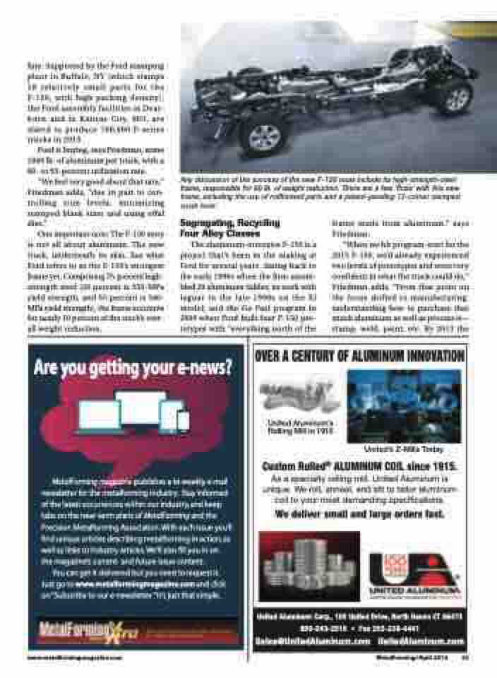

line. Supported by the Ford stamping plant in Buffalo, NY (which stamps 18 relatively small parts for the F-150, with high packing density), the Ford assembly facilities in Dear- born and in Kansas City, MO, are slated to produce 700,000 F-series trucks in 2015.
Ford is buying, says Friedman, some 1000 lb. of aluminum per truck, with a 60- to 65-percent utilization rate.
“We feel very good about that rate,” Friedman adds, “due in part to con-
Any discussion of the success of the new F-150 must include its high-strength-steel frame, responsible for 60 lb. of weight reduction. There are a few ‘firsts’ with this new frame, including the use of rollformed parts and a patent-pending 12-corner stamped
 trolling trim levels, minimizing
stamped blank sizes anSdtayusininfogrmoeffdalof the latest occurrences within our industry,
a
is not all about aluminum. The new
truck, underneath its skin, has what
Ford refers to as the F-150’s strongest
w
frame yet. Comprising 75-percent high- strength steel (20 percent is 550-MPa yield strength, and 55 percent is 340- MPa yield strength), the frame accounts for nearly 10 percent of the truck’s over- all weight reduction.
