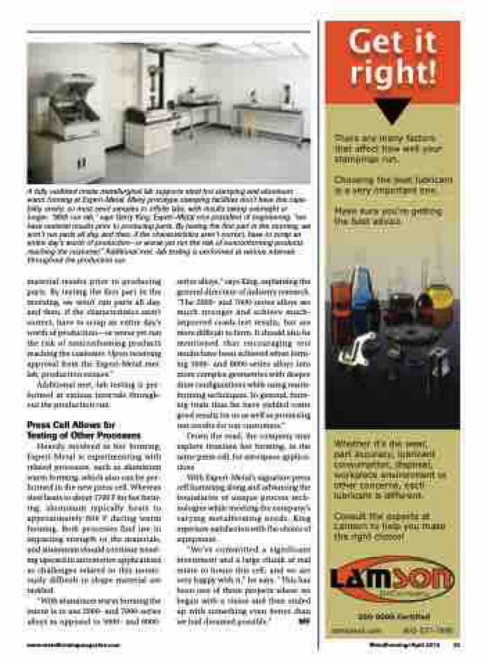

                                                  A fully outfitted onsite metallurgical lab supports steel hot stamping and aluminum warm forming at Experi-Metal. Many prototype stamping facilities don’t have this capa- bility onsite, so must send samples to offsite labs, with results taking overnight or
longer. “With our lab,” says Gerry King, Experi-Metal vice president of engineering, “we have material results prior to producing parts. By testing the first part in the morning, we won’t run parts all day, and then, if the characteristics aren’t correct, have to scrap an entire day’s worth of production—or worse yet run the risk of nonconforming products reaching the customer.” Additional met.-lab testing is performed at various intervals throughout the production run.
