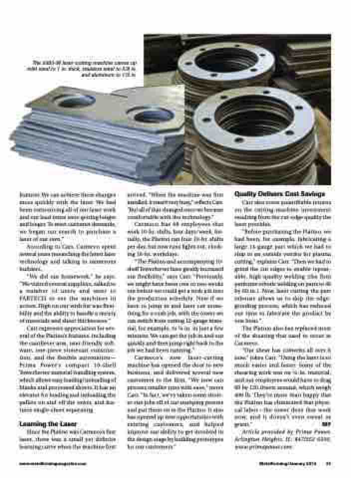

      The 5000-W laser-cutting machine carves up mild steel to 1 in. thick, stainless steel to 5/8 in. and aluminum to 1/2 in.
