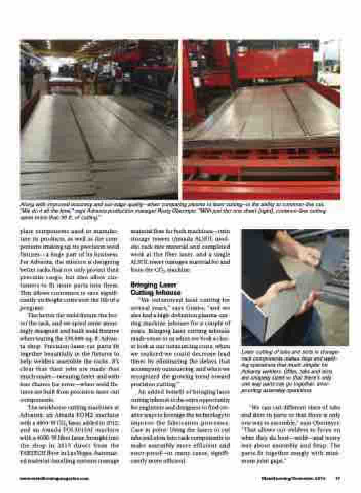

  Along with improved accuracy and cut-edge quality—when comparing plasma to laser cutting—is the ability to common-line cut. “We do it all the time,” says Advanta production manager Rusty Obermyer. “With just this one sheet (right), common-line cutting saves more than 30 ft. of cutting.”

An added benefit of bringing laser cutting inhouse is the extra opportunity for engineers and designers to find cre- ative ways to leverage the technology to improve the fabrication processes. Case in point: Using the lasers to cut tabs and slots into rack components to make assembly more efficient and error-proof—in many cases, signifi- cantly more efficient.
Laser cutting of tabs and slots in storage- rack components makes fitup and weld- ing operations that much simpler for Advanta welders. Often, tabs and slots are uniquely sized so that there’s only one way parts can go together, error- proofing assembly operations.
“We can cut different sizes of tabs and slots in parts so that there is only one way to assemble,” says Obermyer. “That allows our welders to focus on what they do best—weld—and worry less about assembly and fitup. The parts fit together snugly with mini- mum joint gaps.”
