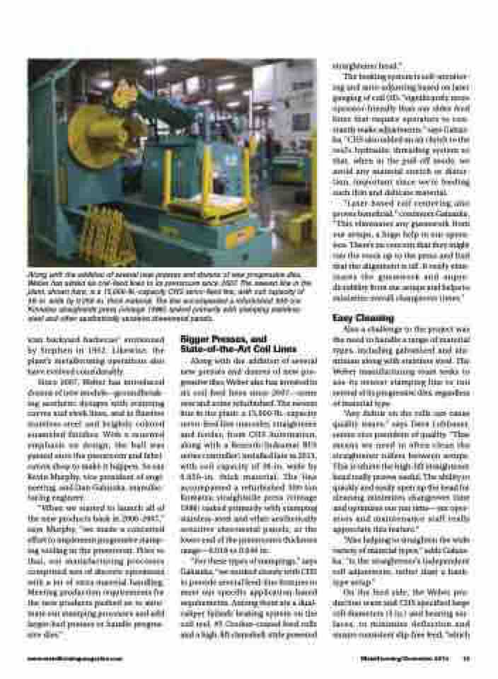

 Along with the addition of several new presses and dozens of new progressive dies, Weber has added six coil-feed lines to its pressroom since 2007. The newest line in the plant, shown here, is a 15,000-lb.-capacity CHS servo-feed line, with coil capacity of 36-in. wide by 0.050-in. thick material. The line accompanied a refurbished 300-ton Komatsu straightside press (vintage 1986) tasked primarily with stamping stainless- steel and other aesthetically sensitive sheetmetal panels.
straightener head.”
The braking system is self-monitor-
ing and auto-adjusting based on laser gauging of coil OD, “significantly more operator-friendly than our older feed lines that require operators to con- stantly make adjustments,” says Galusz- ka. “CHS also added an air clutch to the reel’s hydraulic threading system so that, when in the pull-off mode, we avoid any material stretch or distor- tion, important since we’re feeding such thin and delicate material.
“Laser-based coil centering also proves beneficial,” continues Galuszka. “This eliminates any guesswork from our setups, a huge help to our opera- tors. There’s no concern that they might run the stock up to the press and find that the alignment is off. It really elim- inates the guesswork and unpre- dictability from our setups and helps to minimize overall changeover times.”

Along with the addition of several new presses and dozens of new pro- gressive dies, Weber also has invested in six coil-feed lines since 2007—some new and some refurbished. The newest line in the plant: a 15,000-lb.-capacity servo-feed line (uncoiler, straightener and feeder, from CHS Automation, along with a Rexroth/Indramat RFS series controller) installed late in 2013, with coil capacity of 36-in. wide by 0.050-in. thick material. The line accompanied a refurbished 300-ton Komatsu straightside press (vintage 1986) tasked primarily with stamping stainless-steel and other aesthetically sensitive sheetmetal panels, at the lower end of the pressroom’s thickness range—0.018 to 0.040 in.
“For these types of stampings,” says Galuszka, “we worked closely with CHS to provide several feed-line features to meet our specific application-based requirements. Among them are a dual- caliper failsafe braking system on the coil reel, #5 Crodon-coated feed rolls and a high-lift clamshell-style powered
