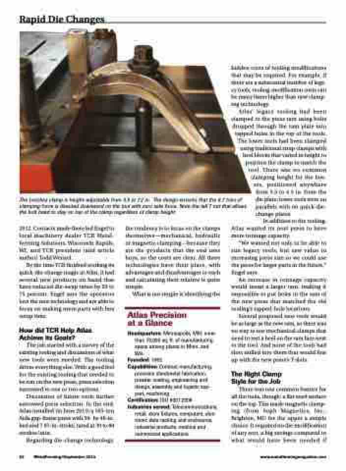

  The Lenzkes clamp is height-adjustable from 3.5 to 7.2 in. The design ensures that the 6.7 tons of clamping force is directed downward on the tool with zero side force. Note the tall T nut that allows the bolt head to stay on top of the clamp regardless of clamp height.

There was one common feature for all the tools, though: a flat steel surface on the top. This made magnetic clamp- ing (from Soph Magnetics, Inc., Brighton, MI) for the upper a simple choice. It required no die modification of any sort, a big savings compared to what would have been needed if
