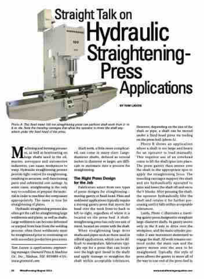

Photo A: This fixed-head 100-ton straightening press can perform shaft work from 2- to 8-in. dia. Note the traveling carriages that allow the operator to move the shaft any- where under the fixed head of the press.
However, depending on the size of the shaft or pipe, a shaft can be moved under a fixed-head press via tooling on the press bed (photo A).
Photo B shows an application where a shaft is too large and heavy for an operator to load manually. This requires use of an overhead crane to lift the shaft/gear into place. The press gantry then moves over the shaft to the appropriate spot to apply the straightening force. The traveling carriages support the shaft and are hydraulically operated to raise and lower the shaft off and on to the V-blocks. After pressing the shaft, the operator hydraulically lifts the shaft and rotates it for further pro- cessing until it falls within acceptable tolerances.
Lastly, Photo C illustrates a travel- ing-gantry press designed to straighten large-diameter shafts. Its gantry moves only in the X axis to drive over the workpiece, and the main cylinder pro- vides Z-axis movement downward to engage the shaft. All work remains cen- tered under the main ram and the gantry moves over the area to be straightened. Typically, this style of press allows the gantry to move all of the way to one end of the press bed in
