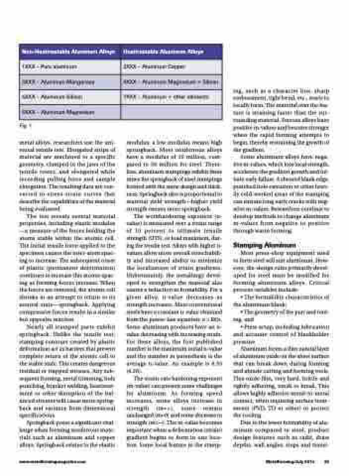

     Non-Heattreatable Aluminum Alloys
1XXX – Pure aluminum
2XXX – Aluminum Copper
3XXX – Aluminum Manganese
6XXX – Aluminum Magnesium + Silicon
4XXX – Aluminum Silicon
7XXX – Aluminum + other elements
5XXX – Aluminum Magnesium
         Fig. 1
