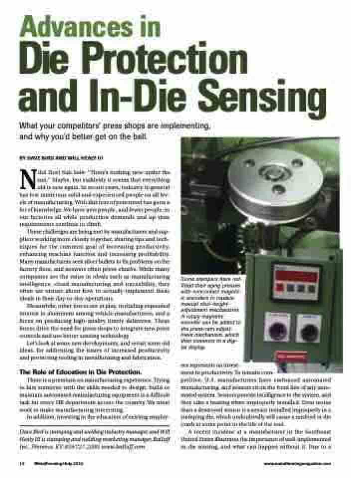

Some stampers have out- fitted their aging presses with noncontact magnet- ic encoders to replace manual shut-height- adjustment mechanisms. A rotary magnetic encoder can be added to the press-ram adjust- ment mechanism, which then connects to a digi- tal display.
