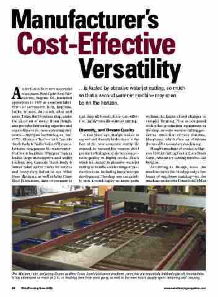

Hough’s machine of choice: a Max- iem 1530 JetCutting Center from Omax Corp., with an x-y cutting travel of 122 by 62 in.
According to Hough, once the machine landed in his shop only a few hours of employee training—on the machine and on the Omax Intelli-Max
 The Maxiem 1530 JetCutting Center at West Coast Steel Fabricators produces parts that are beautifully finished right off the machine. It has eliminated as much as 2 hr. of finishing time from most parts, as well as the man-hours usually spent deburring and cleaning.
