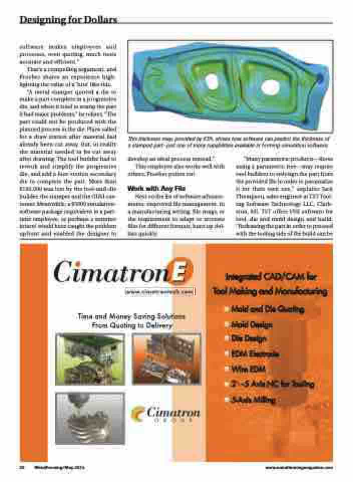

“A metal stamper quoted a die to make a part complete in a progressive die, and when it tried to stamp the part it had major problems,” he relates. “The part could not be produced with the planned process in the die. Plans called for a draw station after material had already been cut away. But, in reality the material needed to be cut away after drawing. The tool builder had to rework and simplify the progressive die, and add a four-station secondary die to complete the part. More than $100,000 was lost by the tool-and-die builder, the stamper and the OEM cus- tomer. Meanwhile, a $5000 simulation- software package (equivalent to a part- time employee, or perhaps a summer intern) would have caught the problem upfront and enabled the designer to
This thickness map, provided by ETA, shows how software can predict the thickness of a stamped part—just one of many capabilities available in forming-simulation software.
develop an ideal process instead.” This employee also works well with
