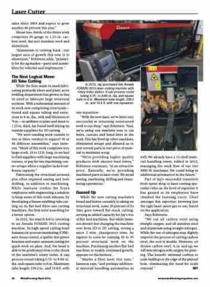

In 2012, the search led to investing in an Amada FOM2RI 3015 cutting machine. Its high-speed cutting head features cut-process monitoring (CPM), auto-focus control, a spatter-free pierce function and water-assisted cutting for quick work on plate. And, the head is able to be positioned close to the chuck of the machine’s rotary index. It can process round tubing 0.75- to 8.66-in. dia. and square tube to 6 in. Maximum tube length: 236.2 in., and 19.6 ft. with
In 2012, Jay purchased this Amada FOM2RI 3015 laser-cutting machine with rotary index station. It can process round tubing 0.75- to 8.66-in. dia. and square tube to 6 in. Maximum tube length: 236.2 in., and 19.6 ft. with one reposition.
one reposition.
