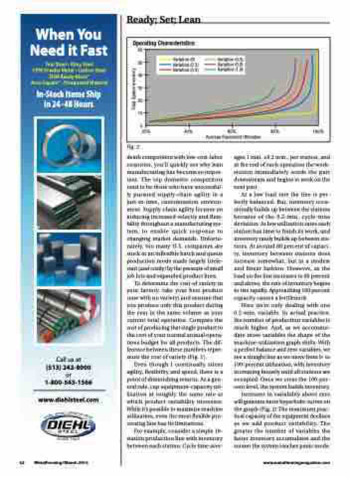

           Ready; Set; Lean
   Operating Characteristics
60 50 40 30 20 10
20% 40%
60% 80% 100% Average Equipment Utilization
  Variation (0) Variation (0.2) Variation (0.4)
Variation (0.6) Variation (0.8) Variation (1.0)

Fig. 2

Even though I continually stress agility, flexibility and speed, there is a point of diminishing returns. As a gen- eral rule, cap equipment-capacity uti- lization at roughly the same rate at which product variability increases. While it’s possible to maximize machine utilization, even the most flexible pro- cessing line has its limitations.
For example, consider a simple 10- station production line with inventory between each station. Cycle time aver-
ages 1 min. ±0.2 min., per station, and at the end of each operation the work- station immediately sends the part downstream and begins to work on the next part.
At a low load rate the line is per- fectly balanced. But, inventory occa- sionally builds up between the stations because of the 0.2-min. cycle-time deviation. At low utilization rates each station has time to finish its work, and inventory rarely builds up between sta- tions. At around 80 percent of capaci- ty, inventory between stations does increase somewhat, but in a modest and linear fashion. However, as the load on the line increases to 85 percent and above, the rate of inventory begins to rise rapidly. Approaching 100 percent capacity causes a bottleneck.
Here we’re only dealing with one 0.2-min. variable. In actual practice, the number of production variables is much higher. And, as we accommo- date more variables the shape of the machine-utilization graph shifts. With a perfect balance and zero variables, we see a straight line as we move from 0- to 100-percent utilization, with inventory increasing linearly until all stations are occupied. Once we cross the 100-per- cent level, the system builds inventory.
Increases in variability above zero will generate more hyperbolic curves on the graph (Fig. 2) The maximum prac- tical capacity of the equipment declines as we add product variability. The greater the number of variables the faster inventory accumulates and the sooner the system reaches panic mode.
Total System Inventory
