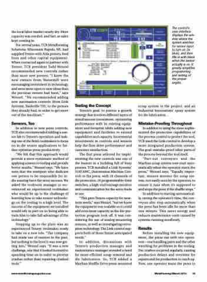

The control‘s user interface displays the win- dow where the system watches for sensor input to turn on (in blue), and then fills in with black when the sensor actually is on. It greatly simplifies programming and setting of the proper angles.
scrap system to the project, and an Industrial Innovations’ spray system for die lubrication.
