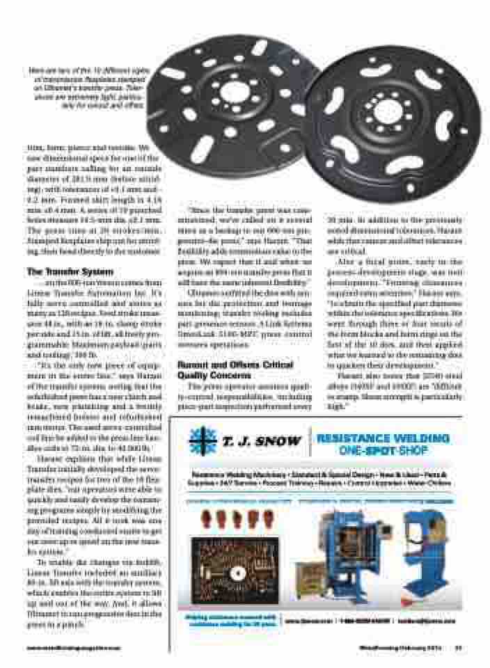

                  Here are two of the 10 different styles of transmission flexplates stamped on Ultramet’s transfer press. Toler- ances are extremely tight, particu-
larly for runout and offset.
