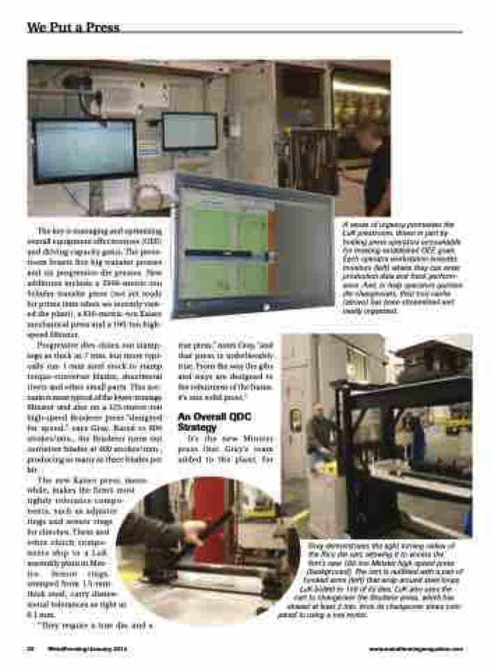

A sense of urgency permeates the LuK pressroom, driven in part by holding press operators accountable for meeting established OEE goals. Each operator workstation includes monitors (left) where they can enter production data and track perform- ance. And, to help operators quicken die changeovers, their tool cache (above) has been streamlined and neatly organized.

Gray demonstrates the tight turning radius of the Rico die cart, allowing it to access the firm’s new 160-ton Minster high-speed press
(background). The cart is outfitted with a pair of hooked arms (left) that wrap around steel loops
LuK bolted to 150 of its dies. LuK also uses the cart to changeover the Bruderer press, which has shaved at least 2 min. from its changeover times com-
pared to using a tow motor.
