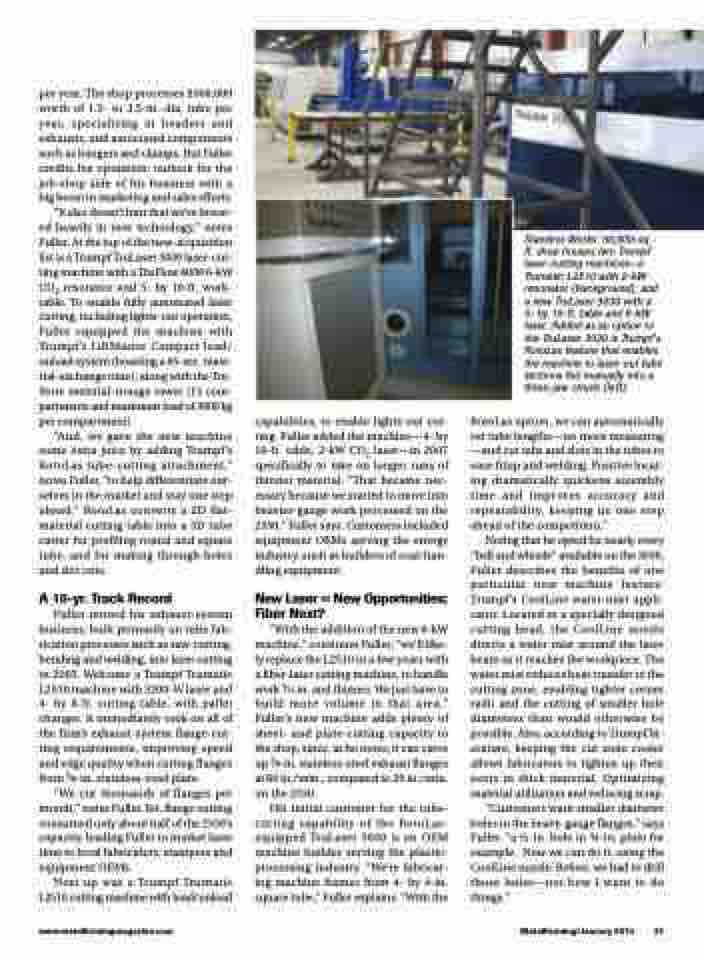

Stainless Works’ 50,000-sq.- ft. shop houses two Trumpf laser-cutting machines—a Trumatic L2510 with 2-kW resonator (background), and a new TruLaser 3030 with a 5- by 10-ft. table and 6-kW laser. Added as an option to the TruLaser 3030 is Trumpf’s RotoLas feature that enables the machine to laser-cut tube sections fed manually into a three-jaw chuck (left).
