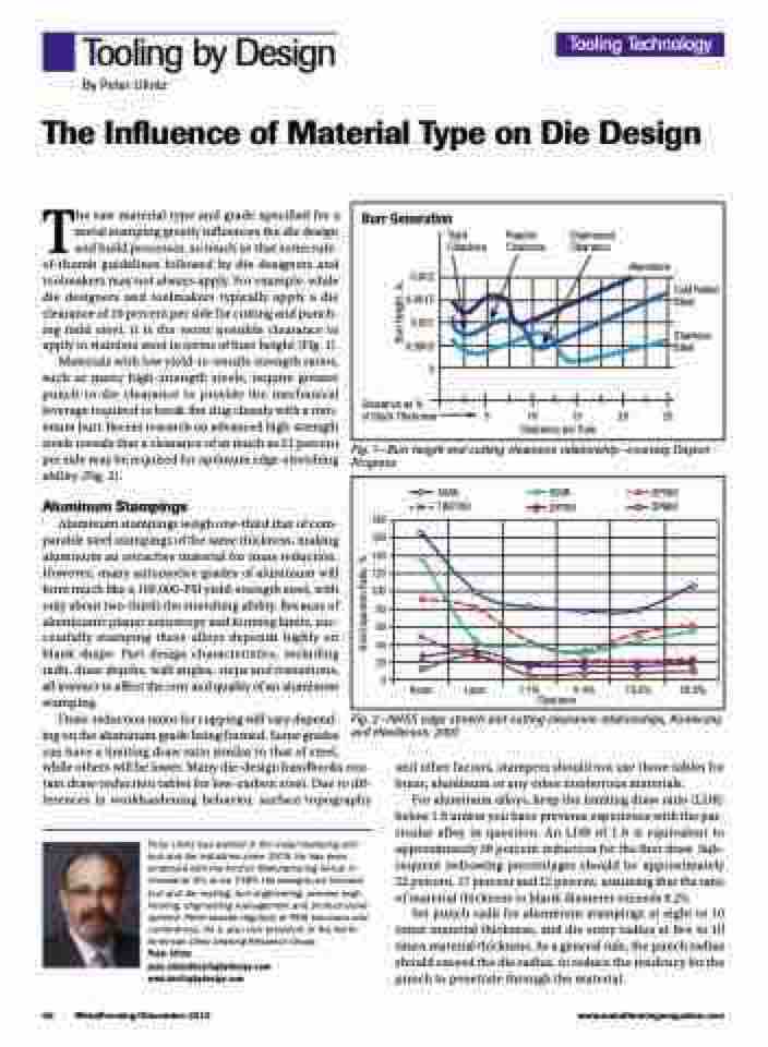

The raw material type and grade specified for a metal stamping greatly influences the die design and build processes, so much so that some rule- of-thumb guidelines followed by die designers and toolmakers may not always apply. For example, while die designers and toolmakers typically apply a die clearance of 10 percent per side for cutting and punch- ing mild steel, it is the worst possible clearance to apply to stainless steel in terms of burr height (Fig. 1).
Materials with low yield-to-tensile strength ratios, such as many high-strength steels, require greater punch-to-die clearance to provide the mechanical leverage required to break the slug cleanly with a min- imum burr. Recent research on advanced high-strength steels reveals that a clearance of as much as 21 percent per side may be required for optimum edge-stretching ability (Fig. 2).

Fig. 1—Burr height and cutting clearance relationship—courtesy Dayton Progress.

Fig. 2—AHSS edge stretch and cutting clearance relationships, Konieczny and Henderson, 2007.
